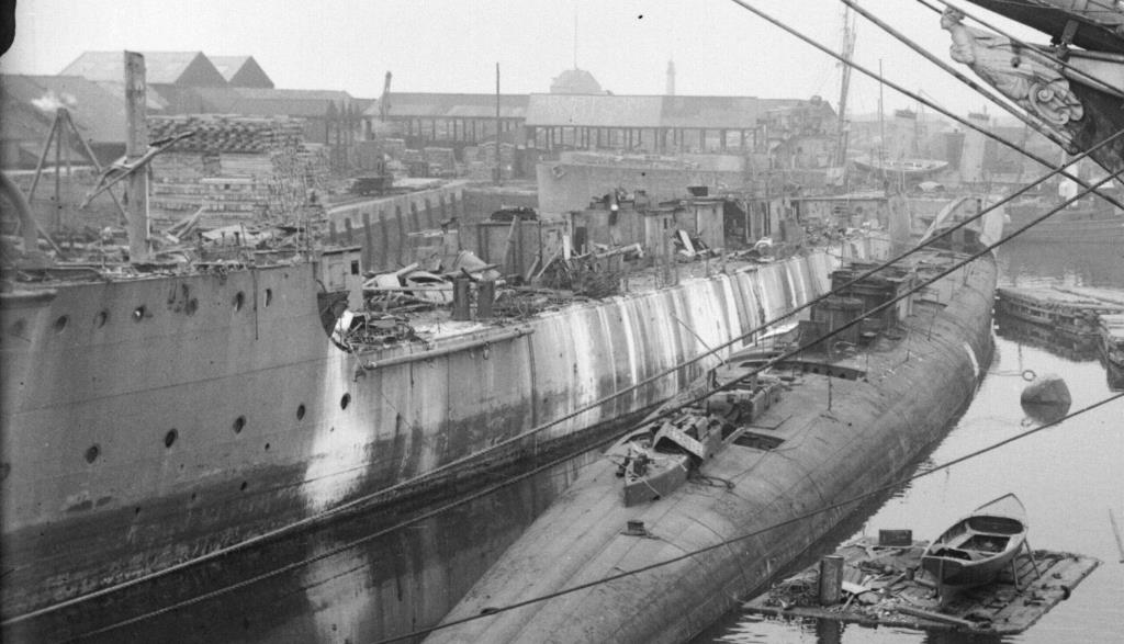

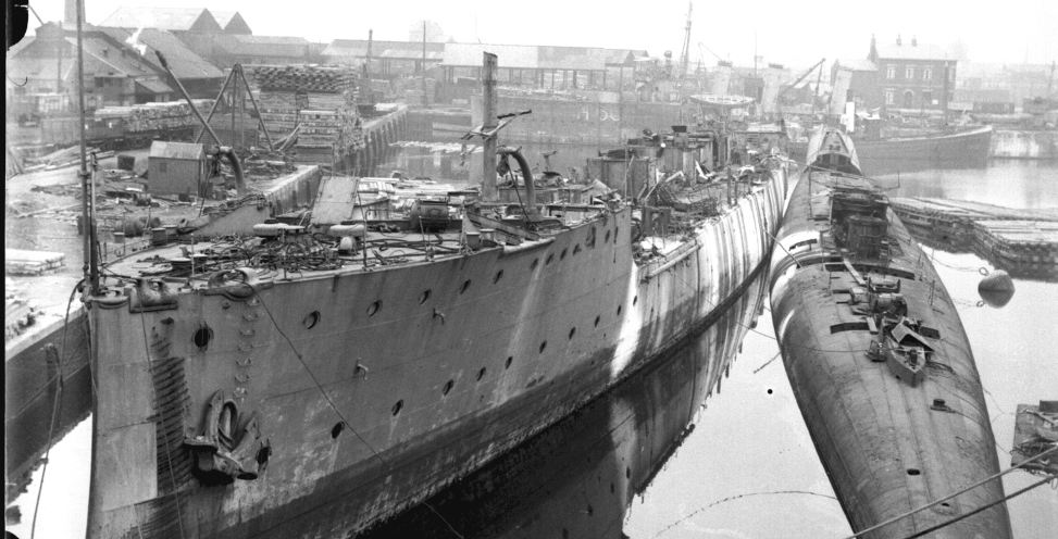

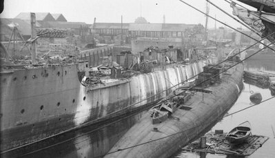

Good Day,
H 60 post WW1 HMS Grasshopper?? being broken up. In the background you can just make out the H 60, in the WW1 style.
A K Class sub in the fore ground well in the process of being broken up.
What would be the Ship on the left of frame.
Raised aft quarter, slightly rounded Ship side, and the Anchor is housed rather low down on the ram type bow.
Mid to late 1920,s
Photograph J.H Cleet
Thanks
H 60 HMS Grasshopper, with K Class sub and unknown HMS on the left of frame.
As above.

Not sure about the H60, but then again I should have gone to Specsavers, however my version of Colledge says she was sold to Fryer, Sunderland 01/11/1921.
Is the photo at Sunderland?
K7 was sold to Fryer 09/09/1921.
She was the only one sold to Fryer as far as I can see.
K13 was sold to Young, Sunderland 16/12/1926

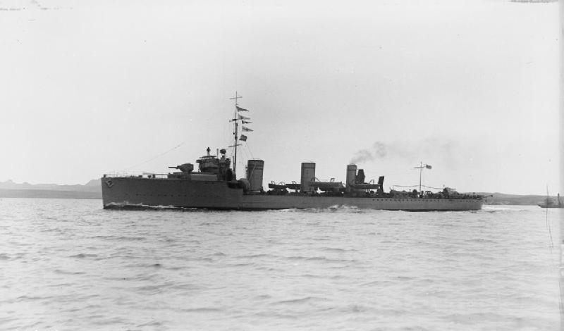

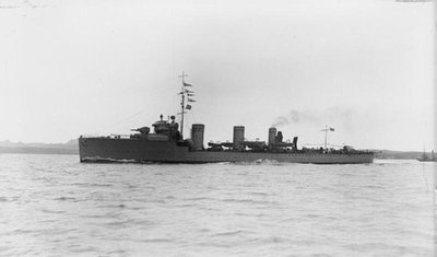

Still not sure about GRASSHOPPER. Attached is a photo of another Beagle Class destroyer & the fat, fat, thin funnels are different from your photo.
also from another site she may have been renumbered H28 some time before her disposal.
See also: https://en.wikipedia.org/wiki/HMS_Hind_(1911) . Note the auto link misses off the final bracket.
This states HIND was H60 at the time of her disposal.

Re the H60 Pennant Number this number has been used by quite a few different ships
LYRA 1914
LIZARD 1918-1919
HIND 1919-1921
CRUSADER
OTTAWA ( Lost)
TRENCHANT
GRIFFIN
No mention of GRASSHOPPER Ever having worn the Pennant Number H60
If the location and date are assumed to be correct then BASILISK was Broken up at Sunderland by Fryer 1 -11 1921 could this be the vessel on the left ?

Postby E28 » Mon Apr 18, 2016 9:55 pm
Ship inboard is the ex HMS Forward, name ship of 2 Scout cruisers.
Built Fairfield, yno 431, launch 27 August 1904
Sold Fryer, Sunderland 27 July 1921
Sister Foresight also survived WW1, sold 3 March 1920.
There were 8 of these Scouts, 4 builders designed and constructed 2 each.
However, i ask why she and the K boat are in that position off the quay,

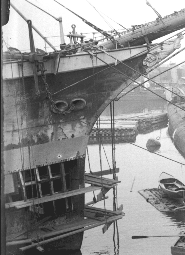

and secondly, which ship does the figurehead top right in second image belong to.
Thats all folks. Sean.

Postby dustydog1 » Wed Apr 20, 2016 12:27 am
Given the lack of cranes, and the floating rafts, it would be easier to have access to both sides of the vessels for breaking and removing smaller items, and leave space for the local coaster to drop off pit props etc. having access to the Quayside, see the large amount of wood in the background.
see more of the sailing? ship photo. sorry you will have to flip the photo horizontally.
Nighttrucker wrote:Re the H60 Pennant Number this number has been used by quite a few different ships
LYRA 1914
LIZARD 1918-1919
HIND 1919-1921
CRUSADER
OTTAWA ( Lost)
TRENCHANT
GRIFFIN
see link. http://www.naval-history.net/WW1NavyBri ... antNos.htm
H 60 noted, as HMS Grasshopper 6-18 , and looking at the photos of the Class looked good for a match. Not looking so good now thou. So have taken Grasshopper out of the thread title.
See slightly more of the sail ship in the new photo attached. The figure head and bow.
Whickham wrote:Not sure about the H60, however my version of Colledge says she was sold to Fryer, Sunderland 01/11/1921.
Possible, J.H Cleet was usually around South Shield, and the North East.
I,ll start another thread on another breaking K class.
requires flipping horizontally. Maybe in for repair to bow shell plating.

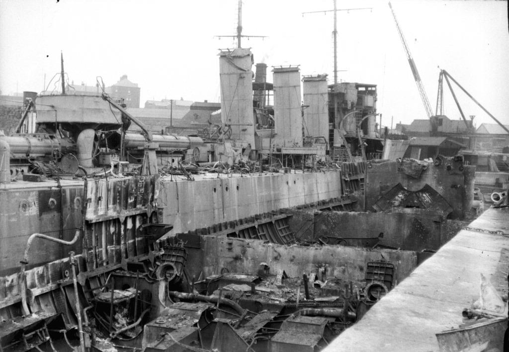

I have a couple more photo which I would like some help with.
If the photo below shows, may be the Stb side of H 60, the ship in the centre, what little is left, would appear to have two large SW inlets for condenser cooling.
What could she have been, given the date period we are looking at, steam expansion engined, or steam turbine.
I say may be H 60 because she may be double, or triple banked, see the mast sticking out the third funnel. Which looks lower down and simalar to the vessel in centre H 60?
The first photo, also shows a coaster with a while (light coloured) funnel with black dark topping. This can also just be seen by the aft torpedo tube back.
The photos in the first and this post by not have been taken at the same time and the vessel could have been moved around.
You thoughts please.

Postby Whickham » Wed Apr 20, 2016 8:41 am
Regarding the funnel of the coaster, this could also be the funnel of a Sunderland Towage tug, vertical stripes with a black top.
See SOUTER an example: http://www.tynetugs.co.uk/souter1910.html
They were taken into France, Fenwick Tyne & Wear Co Ltd in 1918 and had an anchor added to the side of the funnel, but this took a little time to change through the fleet.

Postby dustydog1 » Wed Apr 20, 2016 9:59 am
Whickham wrote:Regarding the funnel of the coaster, this could also be the funnel of a Sunderland Towage tug, vertical stripes with a black top.
My last post should have read (The first photo, of my first thread also shows a coaster with a while (light coloured) funnel with black dark topping. This can also just be seen by the aft torpedo tube back.)
The vertical stripes may be cable hanging down from the torpedo loading davit on the port side.
H 60 does look very long (length) with two sets of torpedo launchers.
Thanks for the suggestions and info so far.

Postby dustydog1 » Thu Apr 21, 2016 9:41 am
dustydog1 wrote:Firstly thank you all for the comments thus far.
I say may be H 60 because she may be double, or triple banked, see the mast sticking out the third funnel. Which looks lower down and similar to the vessel in centre H 60?
If we disregard the H 60 the 3 stack destroyer, looks to me to be more Old 1916 R class. Would any of these class have been broken up in Sunderland in the later mid 1920,s.
dustydog1
