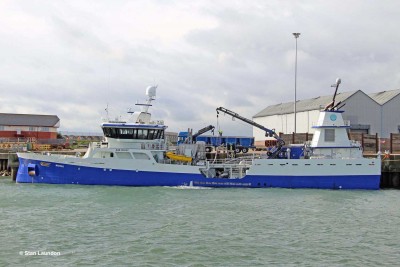

Postby hartlepoolmonkey » Wed Sep 20, 2023 10:59 am
MARSALI loading at Irvine's Quay.
