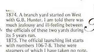

1874 S P Austin went in to partnership with George Hunter at Wear Dock "Austin & Hunter"
Its my understanding that Austin retained his own yard at Wear Dock and the two yards operated simultaneously and independent of each other. Miramar attributes all vessels built at Wear Dock 1874 to 1879 to "Austin & Hunter" with no listing for S.P Austin & Son for the same period.

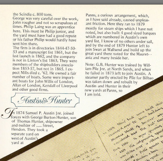

A snippet from the Corder Manuscripts says "They took a separate yard at the west of Austin's yard"
? Did the two yards build under one name "Austin & Hunter" for the duration of the partnership.

But I have the following snippet from the Corder Manuscripts http://en.wikipedia.org/wiki/James_Watson_Corder (attached) which says there were two yards and that Austin built 4 barques for his own yard list , I have to say I can not find evidence of these 4 anywhere.
Happy to go with Austin & Hunter for 18736 - 1879, thanks .

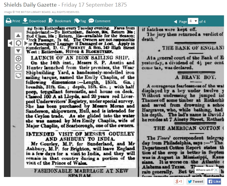

These may be the four barques mentioned by Corder:
Emily Chaplin - 1875
Image copyright British Library Board

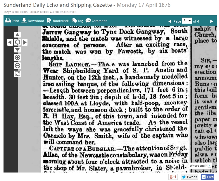

Carmelo -1876

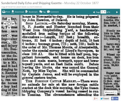

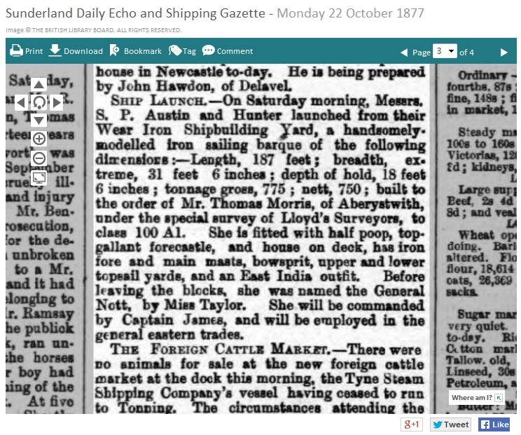

General Nott - 1877

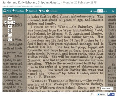

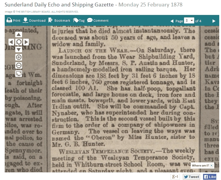

Oberon - 1878
No mention of Austin on his own and the OBERON was launched by Hunter's sister.

Thanks Dave, They built at least 8 Sail Vessels, but at which end of the yard they were built we will never know.
The news articles bring up a new question, was the yard named "The Wear Shipbuilding Yard" ? .
I have S.P Austin at the "Wear Slipway" in 1854 and the "Wear Dock" by 1873, I presume they are one and the same .
