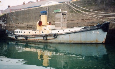

Postby Whickham » Mon Jun 14, 2021 2:48 pm
Kevin Blair sent me this photo of No 296. I think it was taken from the TIC basin at Howdon.
Looks like an Admiralty launch of some sort. Doesn't look like a TIC vessel but is similar to TIC PATROL.
Photo is by John Johnson
Photo by John Johnson

Re: No 296
Postby Hornbeam » Mon Jun 14, 2021 3:27 pm
She does have the look of an early Admiralty Steam Pinnace, Wood Hull, Wine Glass Stern.

Re: No 296
Postby magoonigal » Mon Jun 14, 2021 4:04 pm
Look and ye shall find......
296 (HSL)
Owner: The West Wales Maritime Heritage Society
Area: UK
Hull
Harbour service launch. Construction: Double-diagonal wood..
Built 1942 by Hancocks Shipbuilding Co. (Pembroke) Ltd. at Pembroke Dock
LOA: 52' 6", Beam: 13' 7", Draft: 5' 3",
Raked stem, transom stern, fo’c’sle, original wheelhouse, aft saloon.

Re: No 296
Postby magoonigal » Mon Jun 14, 2021 4:14 pm
Credit to Peter Davison. 1992.

Re: No 296
Postby Hornbeam » Mon Jun 14, 2021 5:33 pm
So the vessel is still "original" barring for a new Hull and a Diesel engine ;) nice little Enginerooms a bit like a TID, the SLRG refers to the Stephenson Reversing gear and the Fire and Bilge Pump are Ram Pumps fitted to the same Crosshead as the Air Pump which itself is driven by a Cantilevere arrangement driven from HP Crosshead ( as previously mentioned)
The "Blast" arrangement on the Circulating water inlet is to clear the Rose Plate of weed and other assorted crud and was done by blasting steam at Boiler Pressure into the Strum Box after the M.E and Circulating Pump had been stopped, and the Inlet Valve closed.

Re: No 296
Postby northeast » Mon Jun 14, 2021 5:42 pm
Sounds like the 'Flying Scotsman', always in existence but are there any original bits still?
Posts: 6581
Re: No 296
Postby Hornbeam » Mon Jun 14, 2021 5:49 pm
As you see N.E. the Hull is very similar in Construction and looks to the John Vincent, just not the same dimensions.
