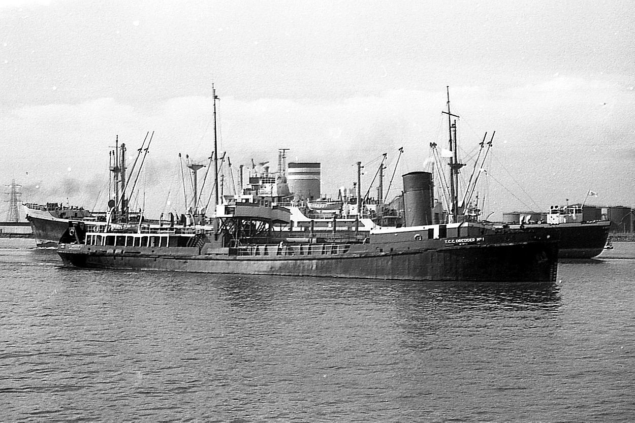

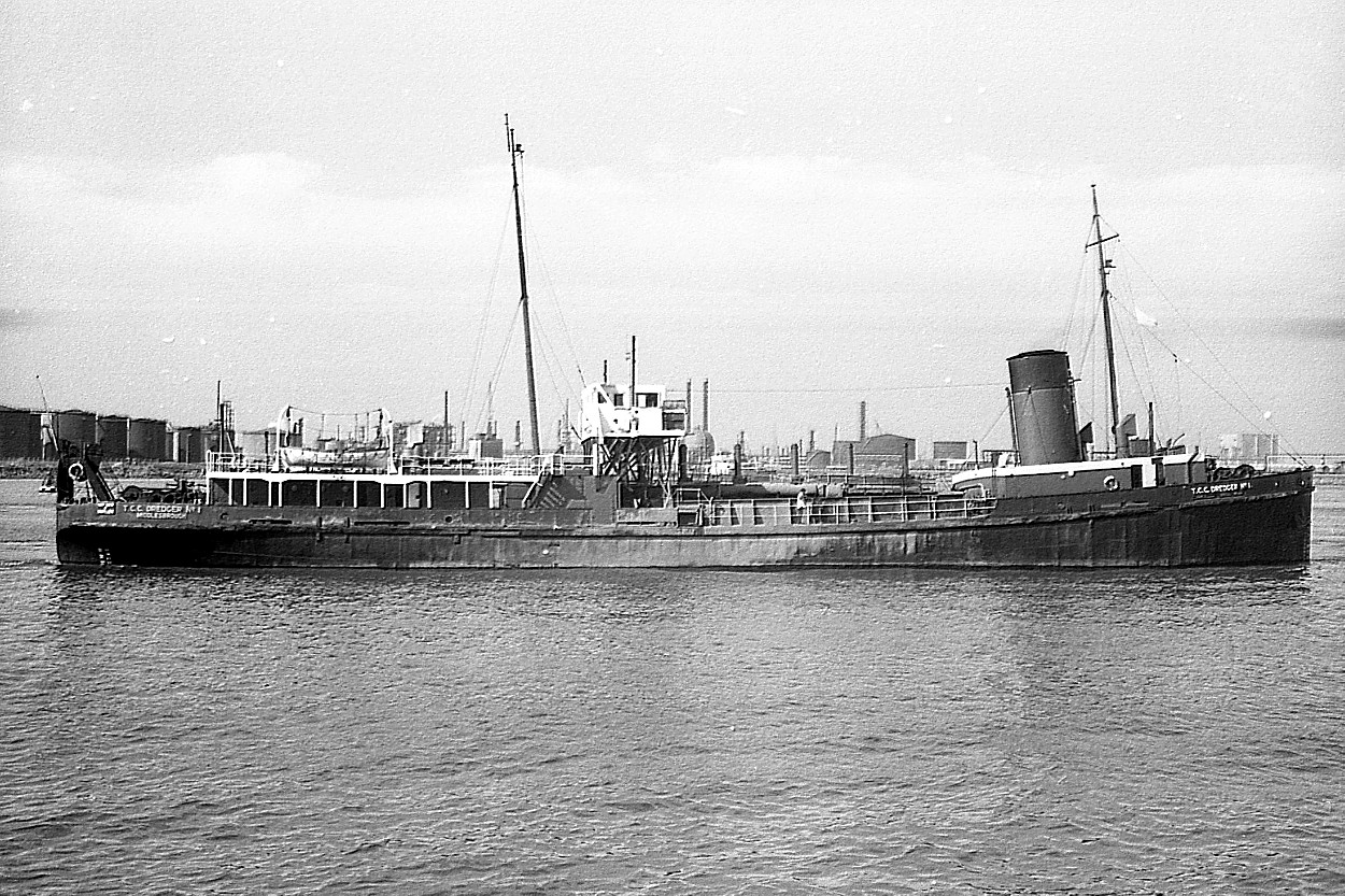

Postby teesships » Wed May 15, 2024 10:15 am
50 YEARS AGO
River Tees - 13 May 1974:

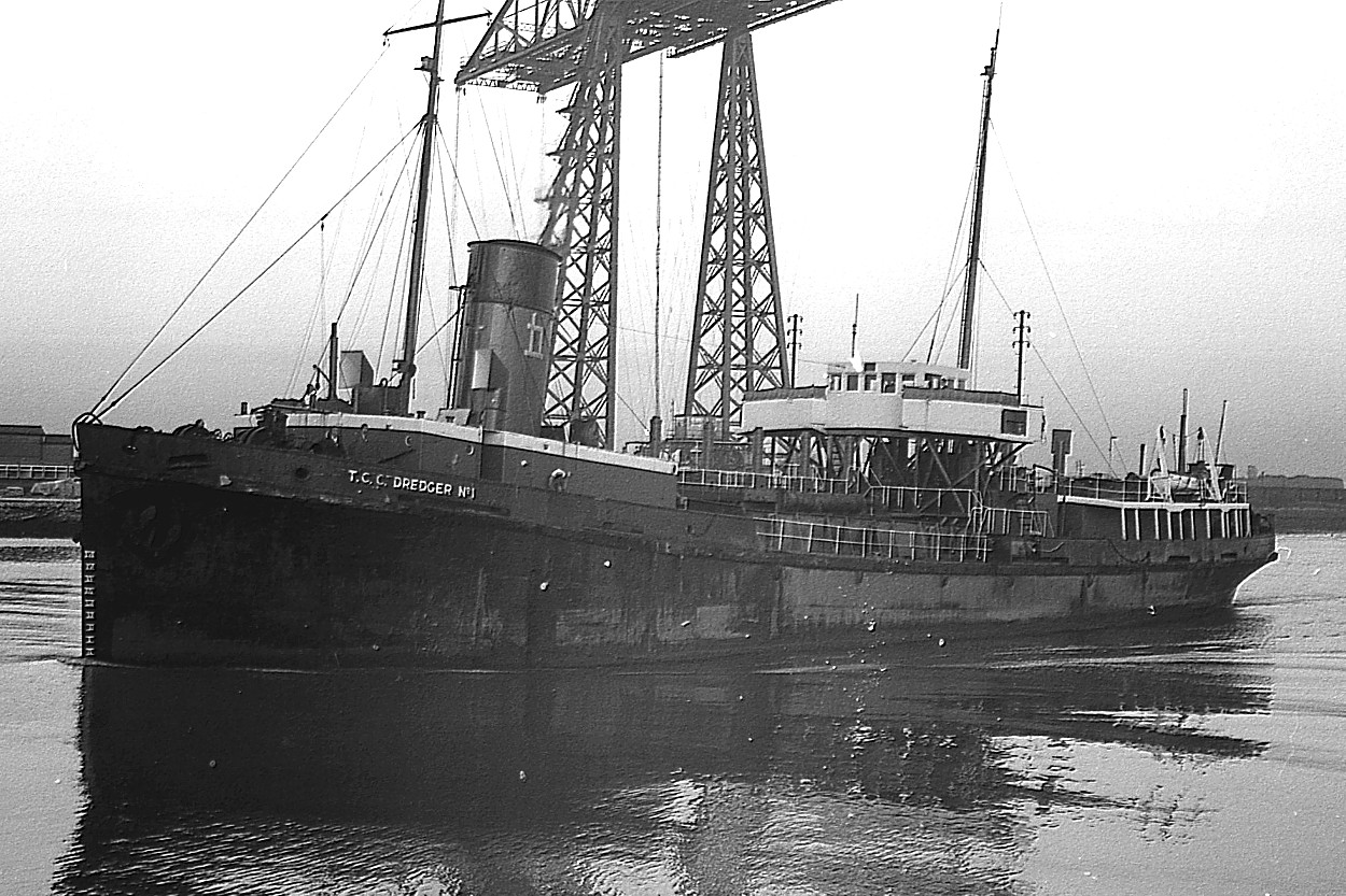

Postby teesships » Mon Jul 07, 2025 9:31 am
50 YEARS AGO TODAY
River Tees - 7 July 1975:

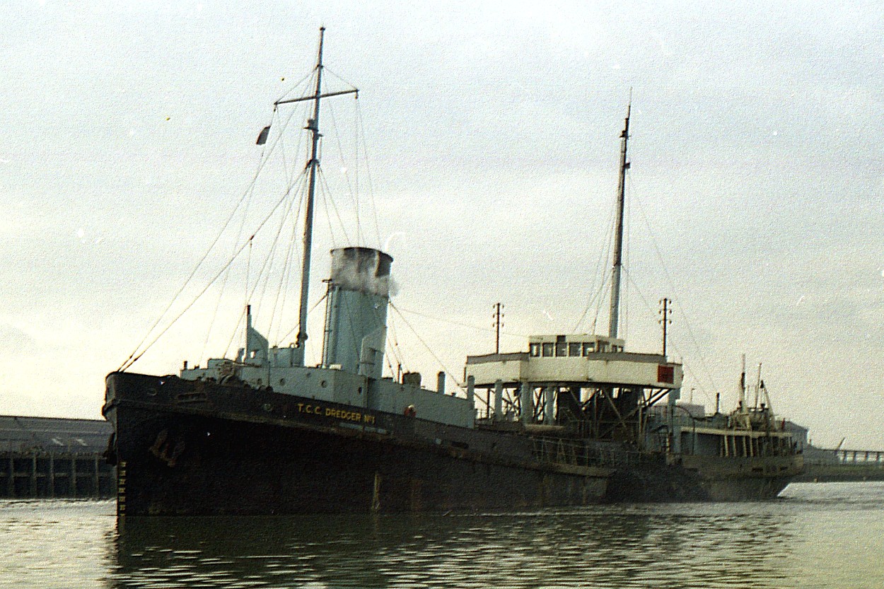

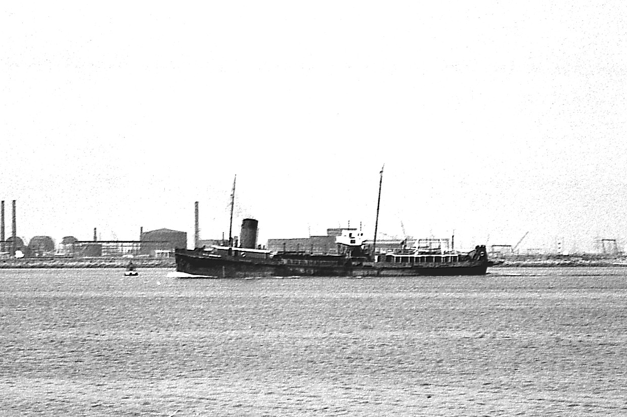

Postby teesships » Tue Sep 16, 2025 10:52 am
50 YEARS AGO TODAY
Off Tees Dock - 16 September 1975:
(nicely framed by the ANDRIANA I pqv] in the second view.)

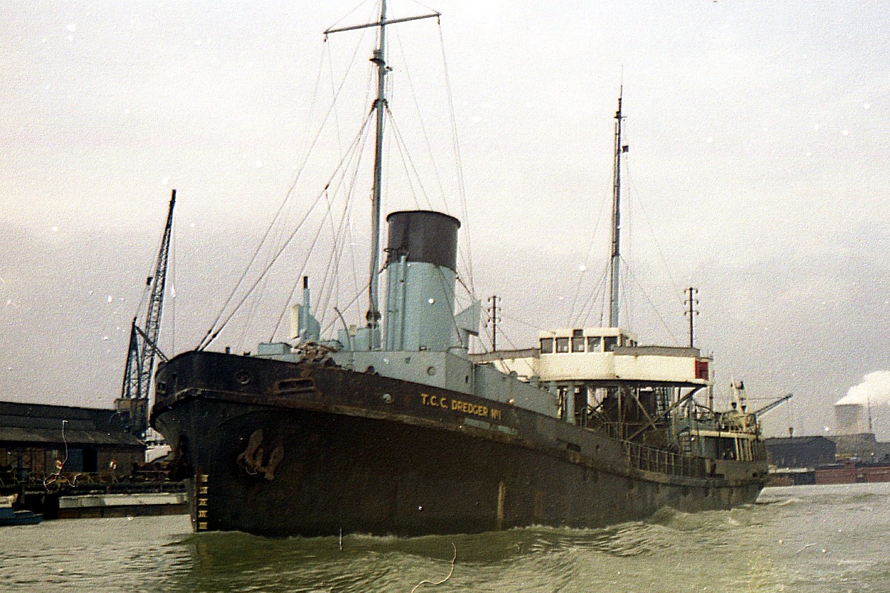

Re: TCC DREDGER No.1
Postby teesships » Sun Nov 30, 2025 7:13 pm
50 YEARS AGO TODAY
Approaching base - 30 November 1975:
